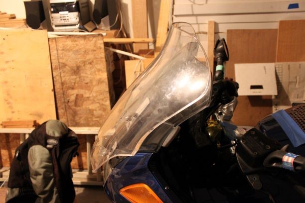

While MadStad has kits for many brands and models, one is not currently available for my K12RS.
So I came up with a prototype that works well for me (see pic).
