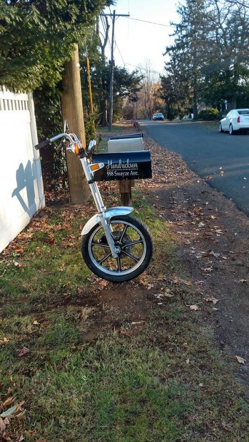

Installed a new mailbox today
    My old mailbox after 28 years needed an upgrade.

        I may copy... how did you anchor it in the ground?

          There is a large cement anchor in the ground with a steel pipe through it. Another pipe is welded to a plate that is bolted to the wheel. The pipe go through the tire and fits inside the other pipe. I can adjust the height by pinch bolts on the outer pipe that is in the cement.

          What I think I said was brilliant job. Even the rake looks right. Is it off an old Kwaka or something?

            Wow your good! 83 Kawasaki 550 LTD. Got a complete motorcycle from my dealer (free) disassembled for the front end. Before I took it apart I got it running. Now trying to sell off the rest of the parts. https://youtu.be/pWl2cd3wyn4
          I guess I could figure that out. Did you bolt through the rotor?

            I drained the old brake fluid from the caliper, drilled a hole and tapped it on the piston side. When I tighten the bolt it pushes the piston out applying the brake pads.

                  Just a 9/16 wrench. Just loosen the two pinch bolts and pull out the post.
