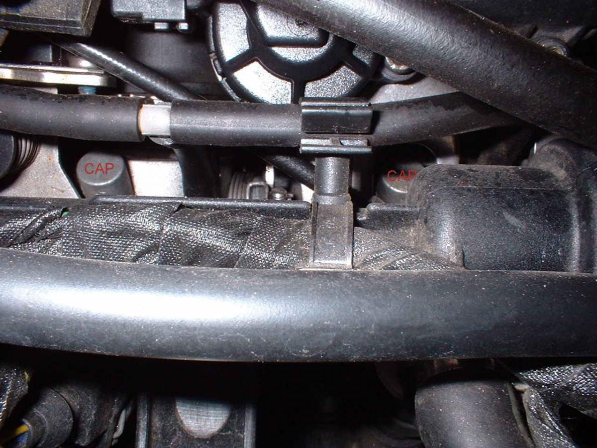

    In 2002 BMW placed a cap over the TB sync screws. They can be removed with a little force.I bent a copper tube to fit the top of the screws and adjusted using an old carb vacuum tube setup.
    The caps ...
      Nice pic!
