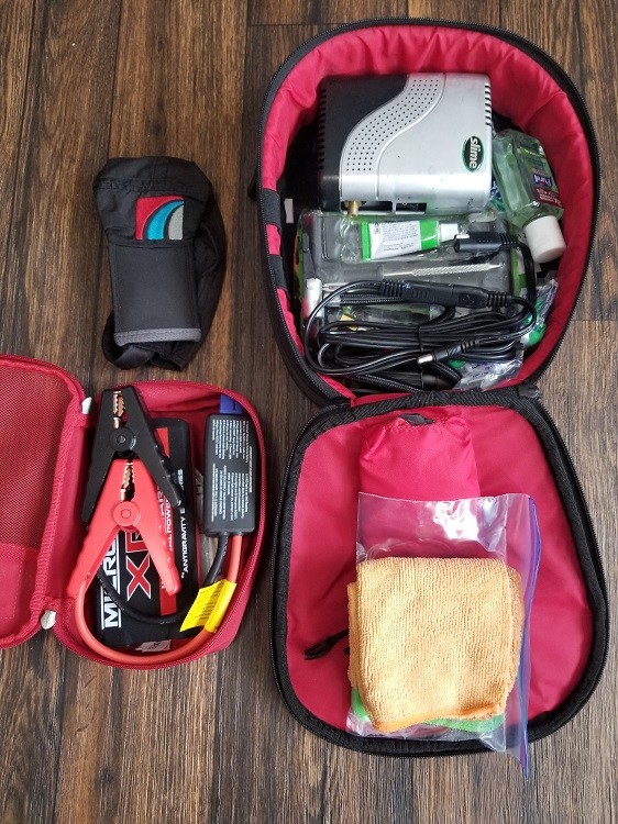

            I got in the habit of always having a tire repair kit and battery jump starter on day rides.
            I have a small tank bag just for day rides.

Name:	Day Rides.jpg

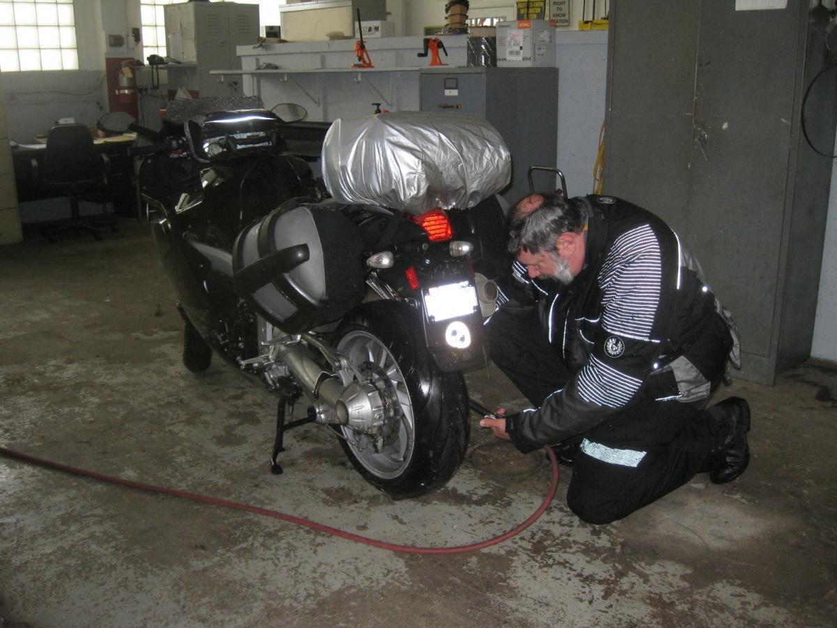

              Doug, it was BRPR 2009. We started feeling the bike unresponsive like Rob mentioned above. I pulled into an overlook on the Parkway in the rain to access the situation. It was bad. (No TPM on this bike.) The tire has a puncture. I was sitting on my butt observing this joyous moment when several US Park Ranger vehicles entered the overlook. They were doing search and rescue training. I asked if there was anywhere nearby where I could get air. Their maintenance shop was only a mile away but they were not allowed to let the pubic use the shop. I walked away, sat back on my butt, and attempted to get decent tire pressure with CO2 cartridges. Then they walked back over and said, "Follow us." Off to the shop we went. Nice guys. Rules are rules but there are time when they just shouldn't apply.
              The shop.
              Click image for larger version  Name:	1-IMG_1190.JPG Views:	1 Size:	131.9 KB ID:	27398

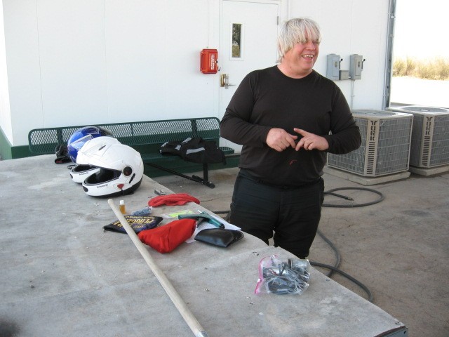

              . We had time to find a shady spot.
              Shade is nice.
              Click image for larger version  Name:	Picture 024.jpg Views:	2 Size:	70.7 KB ID:	27401
              Click image for larger version  Name:	Picture 023.jpg Views:	2 Size:	61.0 KB ID:	27402
              That's the day Randy learned the accessory outlet on the newer bikes won't run a air pump.
              Click image for larger version  Name:	Picture 025.jpg Views:	2 Size:	83.6 KB ID:	27403

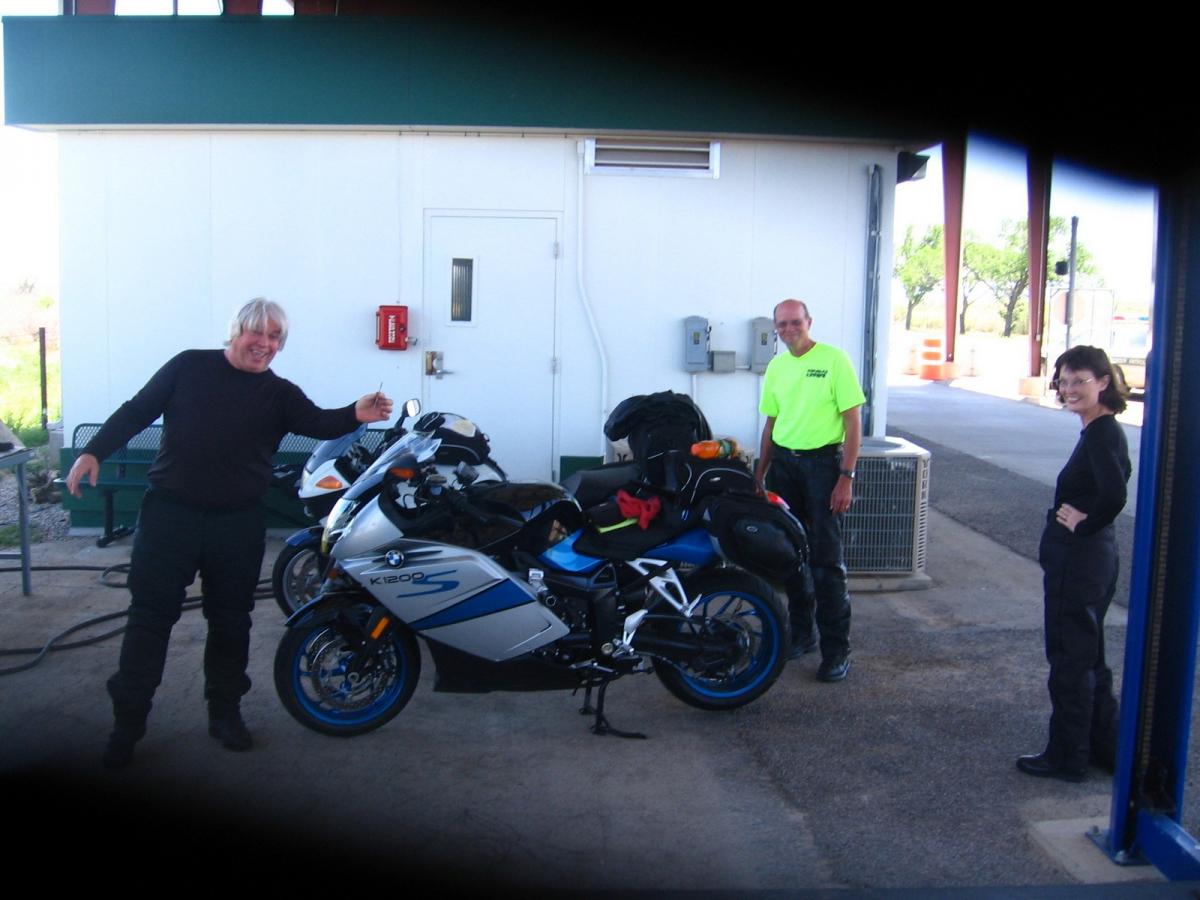

                  Here's a pic of that day in April 2007, Randy holding the nail that prevented the tire from holding air. This was also one year after Randy came rolling into the checkpoint, having the Border Agent ask if the was a US citizen. Randy replied, "Si senor'. He was released a few hours later. Click image for larger version
