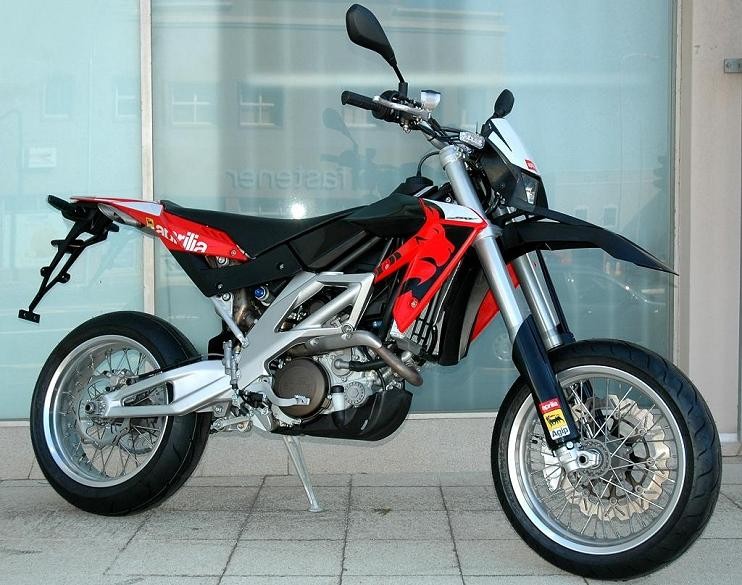

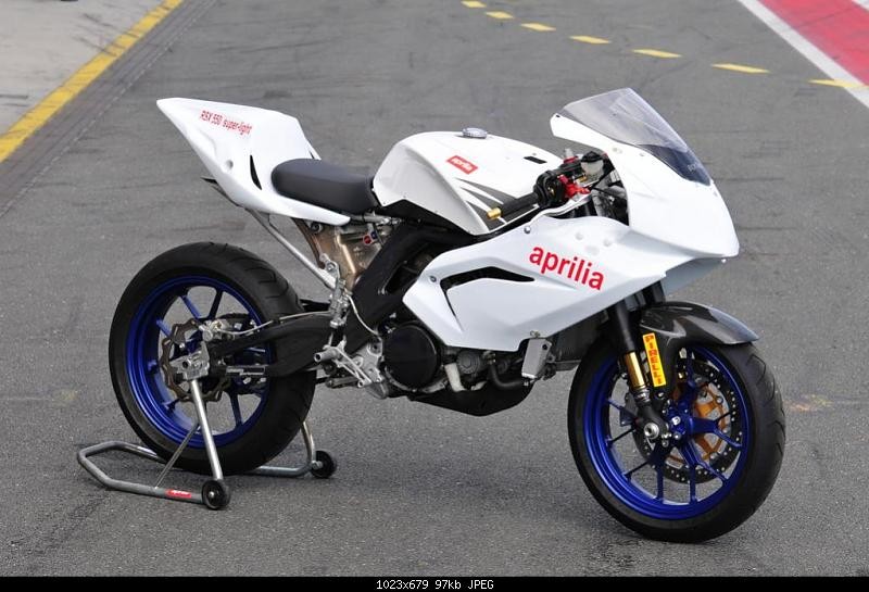

    I purchased an aprilia sxv550 this year converted to a road racer. It's a real lightweight and I will be bringing it along later in the year when I finish it. 280#'s and 80hp. It's a little firecracker!
    Here is a stock photo.

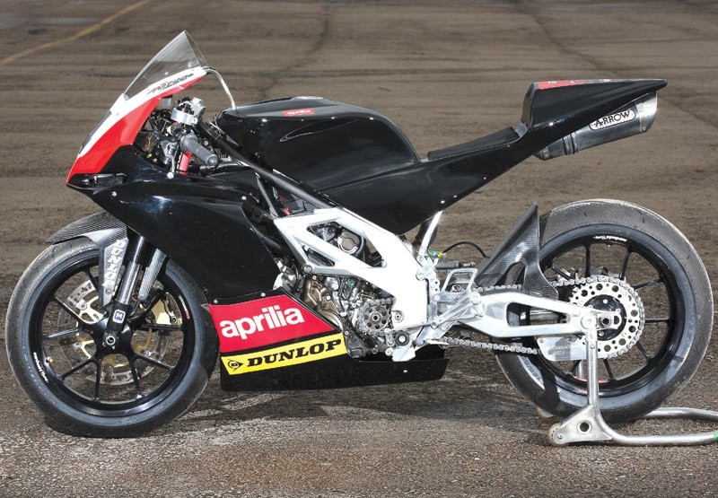

          This bike belonged to a Aprilia AMA 250gp race champion Chuck Sorensen. He imported the kit to build a lightweight bike to compete locally in some AMA events.
          Sounds like the engine was too fragile and overheated a couple times. There are geometry and gearing issues as well that limit the use in full on racing. But for little ol' me, it should work just fine.
          Here's an internet blurb about the bike...
          https://www.bike-urious.com/beon-gp-...50-road-racer/
          It has changed hands once. The new, previous owner lowsided on cold dunlop slicks and sounded like he just parked it for a year. I picked it up and IMHO, it was really rough around the edges.
          fairings were damaged, seat position was too angled and put too much pressure on my wrists and the tank was too short forcing me too close to the bars. The starter was going out when I got it and finally failed. The flywheel/timing rotor woodruff key broke off. I needed a flywheel puller and new key to replace that. with the race gearing, the chain rubs something awful on the swingarm and goes through chain guides every weekend reportedly. So I went with a larger front sprocket that required some relieving of the swingarm to fit. LOL. So, a lot of work is being done. I can see why the bike was built, 280#'s and 80hp is an awesome combination. but I see why it has changed hands twice as well, now...
          In europe they have these RRV450 conversions that race in a series back in the early 2010's. they are beautiful...

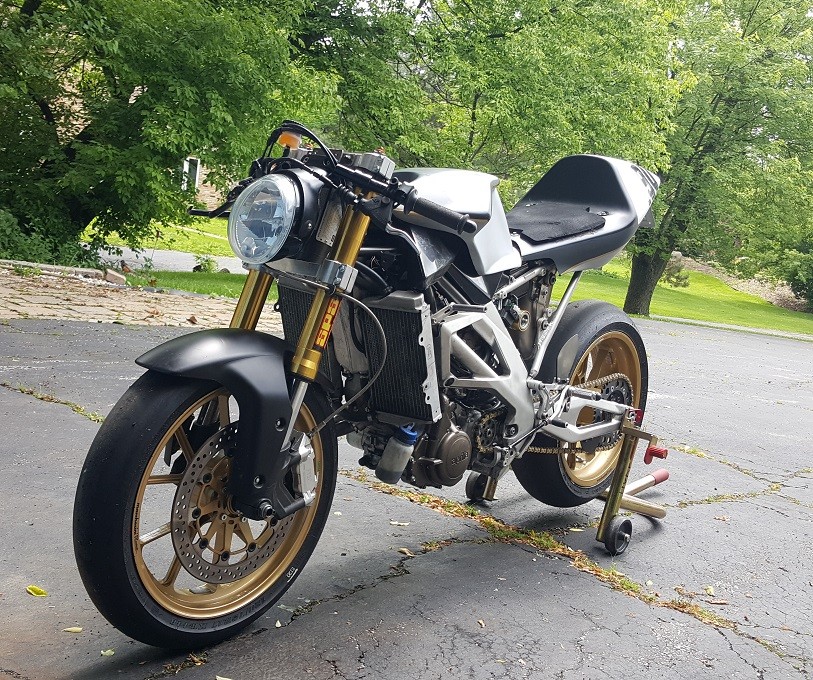

            My first priority is to make it road legal so I can familiarize myself with the bike. I just don't have the resources and time to get to trackdays as much as I would like.
            I got my title and mounted a Vrod headlight I had lying around from previous build. I fabbed a taillight/license plate bracket as well and I snuck it out for a couple shake down runs.

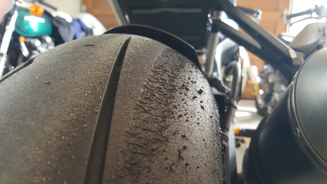

                  One thing though, Bruce, is that I either seriously was off on my tire pressures or had a major suspension/geometry setup issue because I dug a shallow ditch in an almost brand new supercorsa SP rear in one day. And this is with a mostly stock 750 powerwise. Not that I was so fast on it, but somehow it's probably set up wrong.
                  My rear was 26 psi in the morning off the trailer and 30psi coming off the track. Maybe 2-3 mins before I got back to the pits and off the bike and the tire pressure measured. I didn't think at that time it was too bad.
                  Earlier in the day, the tear was on/off around the circumference of the tire. making me think it was a suspension issue. But I thought, I'm so slow and guys and a gal was passing me, what do I have to worry about tire wear. The rest of the day I was working on getting on the throttle earlier to keep up with the fast guys coming off a long right hander onto the straight. By the end of the day, I was surprised I've almost ruin this tire.

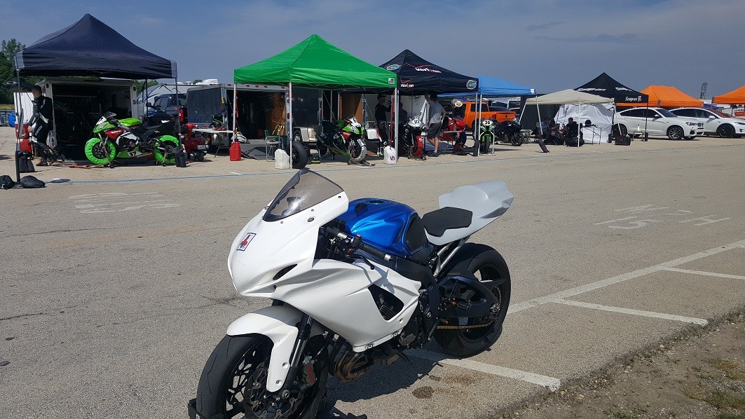

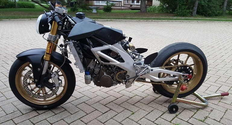

                    Here's the bike... Yeah, I'm too lazy to paint it.
                    Click image for larger version  Name:	 Views:	1 Size:	239.7 KB ID:	7816
                    Click image for larger version  Name:	 Views:	1 Size:	174.6 KB ID:	7815
                    The day was definitely not as crowded as the first trackday of the year on memorial day.

                      A few things in regard to your tire - Pirelli depending on the track - a track with good grip you could run it @ 30 psi - it should have cleaned the tire up - I think you were late on the throttle coming out of the corners - and when you stand it up you get hard on the throttle because you are a little late trying to make up time. Have to be careful of course too early on the throttle and bad things will happen. I doubt your suspension was the cause.

                          Bruce, I noticed that, too. And I consciously tried to throttle on earlier! That said, the gsxr is a dinosaur with no TC, ABS, IMU, or other electronic nanny, so I am extra careful on the throttle until I reduce my lean a little. I could be better, though for sure.
                          Still, i dont how this should happen on a 750 with maybe 120hp.
                          my pressure off track was 30 psi. did you mean cold pressure at 30? i had the feeling from looking around at Dave Moss stuff that this was a cold tear. in fact, i even downloaded some of his tire reading videos and i almost exactly match what he calls a geometry cold tear. He says very common with people slapping larger rear tires on and pitching the chassis foward.
                          This immediately rang true to me, because im running a larger 180/60 but also a longer rear shock AND shim to correct the swingarm angle.

                            30 cold in my opinion is too high - that would possibly get the tire up to 34 when hot and I think you would have grip issues. Now reading what you have done to the bike - certainly that plays into it - but I think until you get to another track and see what happens - I would try carefully getting on the throttle sooner coming out of corners. The reason I say another track - I go to a track that is relatively short - counter clockwise direction - and I have this issue - not as bad as you but very similar.
                            I know I'm late on the throttle - and because of that I hammer it to make up for lost time - and I do raise pressure to help clean up the tire - you could go 1 or 2 psi higher but again be very mindful of grip.
                              Yeah, that's what I thought, too when I read your post. You couldn't have meant 30psi cold.
                              I was 26psi cold, 30.5 psi hot off the track (with maybe a 2-3 minute delay in measuring rolling back to the pits). I had the tire guy check my tire gauge in the morning and I was like 1/2 psi off his.
                              I agree I must be ham fisting it once on the fat part of the tire. But I did consciously think about rolling on early. Usually depending on the corner I'm on just before apex. Learning though that every corner is different and some I try to trail in deep and get to the corner faster. Some, I roll on throttle early to get the best drive.
                              I like talking track stuff. I should have talked to the tire guy trackside. The usual suspension tuner was not scheduled this weekend. The amount of stuff in Dave Moss' videos in reading tires is mind boggling. I spent the couple nights going through some of the videos after I ponied up $8 for a monthly subscription.
                              To others, if your mind likes to work like mine and want to know the why of things (maybe to my detriment at times) the videos are definitely worth a look.
