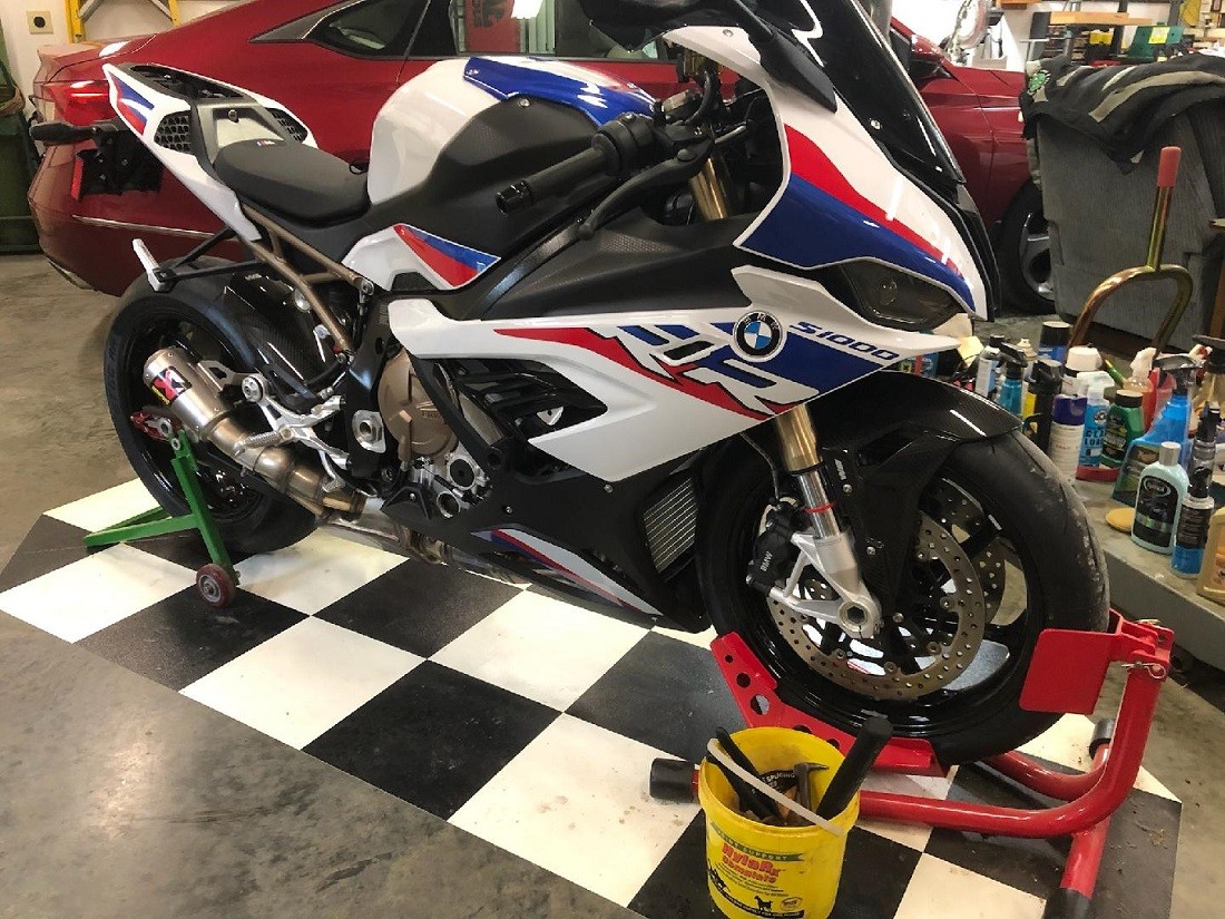

      I thought it was odd that Steve's (Hunter) S1000RR was delivered last week with what appears to be Hayes calipers.
      Click image for larger version  Name:	Steve's RR.jpg Views:	2 Size:	299.2 KB ID:	33355
