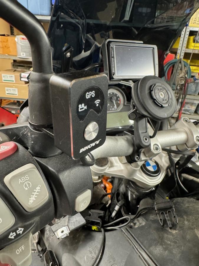

      I have the Quad Lock with shock mount and charging. Haven't test it yet.
      Click image for larger version  Name:	0167EB4D-C425-4E89-9C96-A1D02E8E716F.jpeg Views:	1 Size:	97.3 KB ID:	54253
        I have the same mount and it was the cable between the quad lock and the power port on the dash that kept failing. Not sure why as there was no tension on it but there was also no support so it would flop around a bit on the ride.
