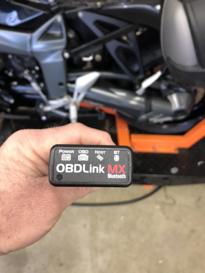

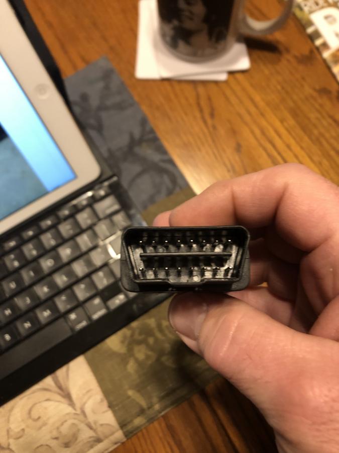

ID:	18919Click image for larger version

                Looks like a great deal.
                Is $130 the total cost for the scanner, cable and app?
                Does the scanner come with a cable or rectangular connector that fits the newer bikes making the total approx $110?

                  Click image for larger version  Name:	3F3A7F5D-483A-432D-A5F0-24E28A6F02CD.jpeg Views:	1 Size:	57.0 KB ID:	18926
