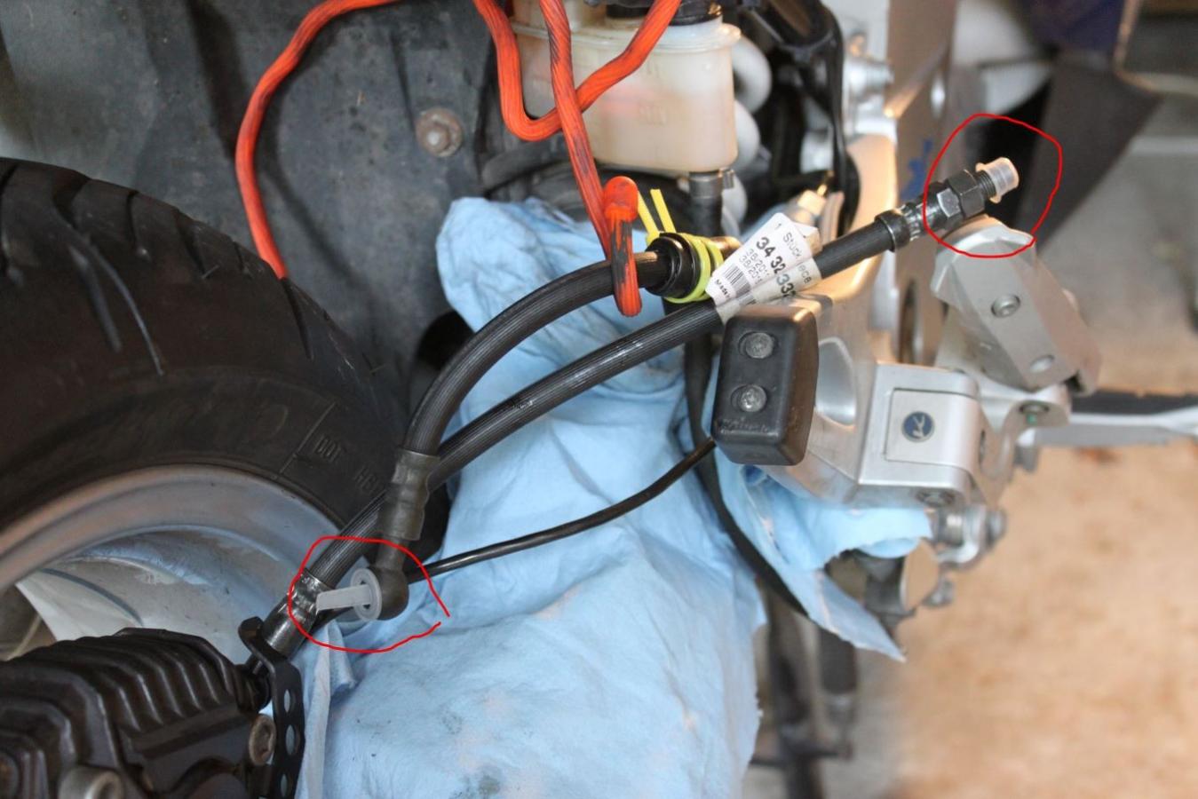

4. This and the next steps describe how to replace the back brake hose without completely draining the back brake circuit. The back wheel was freed and the brake caliper bolts removed. The old brake hose was detached from the caliper and its distal end was immediately plugged with the distal stopper from the new brake hose (see pic #1). The new hose was attached to the caliper, renewing the two crush washers for the banjo bolt. The banjo bolt was torqued to spec. Note that loosening and tightening the banjo bolt is facilitated by having the caliper on the rotor and being able to change the position of the caliper on the rotor.
Pic #1: Old and new brake hoses; note plastic plugs on the open ends of each.
