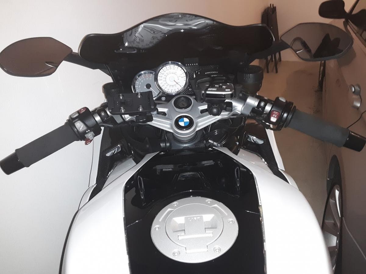

    Question for those who have installed Helibars. How do you keep the clutch cable from snagging on the ignition plug cover. The cable is secured against the faring and is threaded around a part of the wiring harness, so it would be difficult to get in there and Can I file off the point of the plug cover so the clutch cable can slide over it more easily?
      Hi, you have to clip the zip tie inside the right fairing. It hard to get in there but be very careful that all you clip is the tie. Once that's done the clutch line will be just long enough to clear the ignition. Clipping the zip has no negative effects.

    Helibars installed. Raining now so have to wait for test ride.

        A little more upright and comfortable position. The change isn't radical structurally (only about an inch up and half an inch back) but I think it's going to be enough to significantly reduce pressure on my wrists. Doesn't look any different at a glance.
      #21
      Ride about two hours this evening. No wrist pain. The position is upright to the point where I can hold the grips and have virtually no forward leaning pressure. This is really going to help alot. Thanks for the advice to try theses helibars before giving up on the KS.
