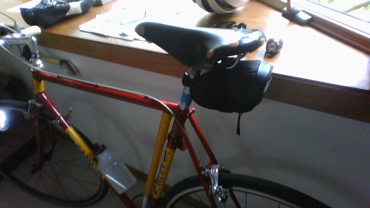

        And two days ago I dug out a Brooks leather saddle that was never used.
        Treated with leather softener before adding.
        The saddle is at least 2 decades old and the shoes are from the early 80's.
          The theory is the leather conforms to you sit bones after awhile.
          Haven't gotten there yet.
          I really like my Brooks for daily riding. However, the front of the pommel is too hard for my personal aero position if I want to stay low in the drops for very long.
          I rode it on a 40-mile ride the day I installed it out of the box. No problems at all. The only thing I noticed as it "broke in" is that I had to adjust the tensioner a few times.
          9951, I've noticed that also.
          Right now I'm trying to adjust the seat attitude for a balance between upright and crouched.
          Too steep and you slide forward.
          Too shallow and you have to worry about nerve damage (of the worst kind).
          It may not work out.
