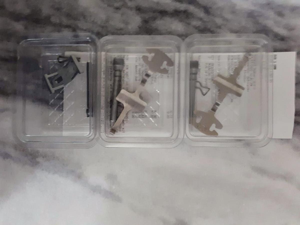

    FedEx found us! Too late I realized Max BMW would have sent M&Ms.
Name:	jZRDcx2jt49yqSJePovVuOvcITdf1UzfXdmNXsbvjUcop-iIrps04SyOMM-w7iiMerrcRD0uc09DtwFjeEI_tfd6alHlh4yYzLFMje3nuATefeI3bbQwO4XjcUzTAMx6cwHp8kajU1F8I4eRdTwiCtjgJRgy8_LPMDT3-IAcEUS3cft_fAQZ2T67T1WouW-4_ffoZ3y_TQ5S0OwZ1r1tN6ljoBklxgjTsIS5_zWw2wrFyi1C47dtsIRo-JTZPrS
      Keep your old wire clips. If you loose one you need to buy a new kit.
      Yep. I keep all kinds of stuff like that.

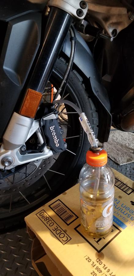

      I finished my winter maintenance today, EBC brake pads front & rear & a fluid flush with Liqui Moly Dot 5.1 fluid.
      1st time using my fancy one man brake bleeder, a piece of plastic tube that fits tight over the bleeder screw & a gatorade bottle...worked great.
      Just put the tube over the bleeder drill a hole in the top of the bottle add some old fluid to the bottle fresh fluid in the master open the bleeder& pump away.
      Click image for larger version  Name:	20220227_143201.jpg Views:	1 Size:	62.5 KB ID:	36542
        You forgot that a cardboard box is needed to put your Gatorade bottle on?

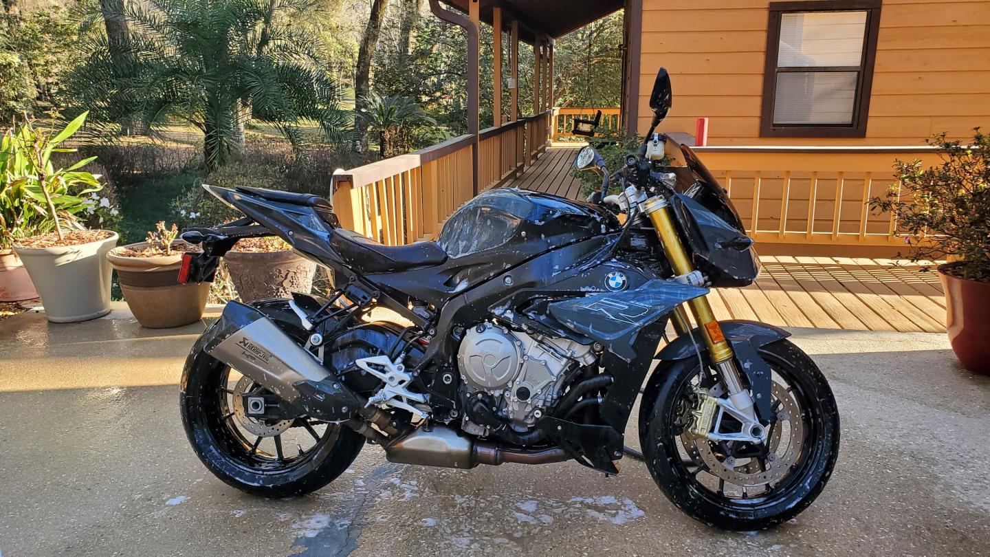

        Gave her a bath.
          Everyone likes a sponge bath !
          Pete, I like that scheme on RR's. The slightly different, but complimentary grays and blacks, keep from chopping up the lines as much as some of the other schemes.

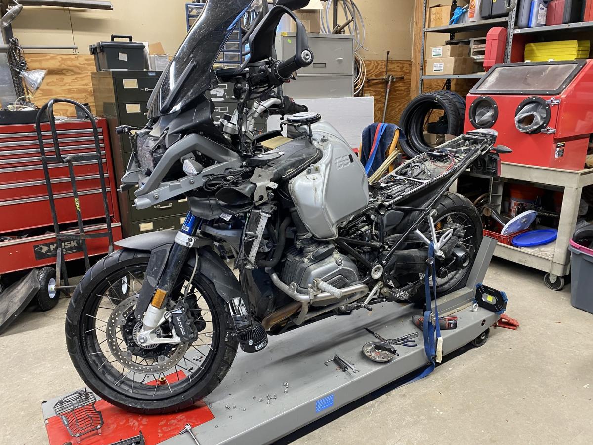

            I hope I can remember how to put it back together.....
            What my brother told his wife when she was asking when he was going to finish a home project:
            "Honey, I'm a starter carpenter, not a finish carpenter."

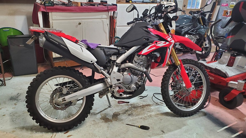

                    I have a very loose plan.
                    Pete, your "loose plans" usually turn out to be very interesting.
                    I was feeling the need for a small enduro bike.....
                    Then my tax guy emailed me the damages

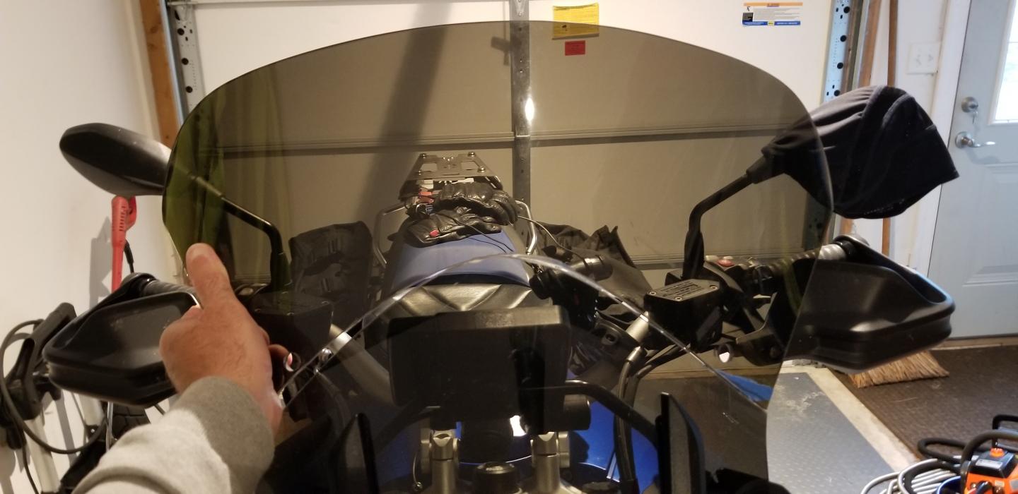

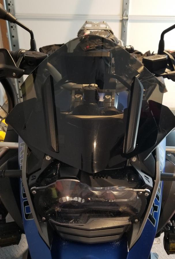

                  I made a shorty windshield for the GSA out of the windshield from my K13GT. I had to drill new mounting holes & cut it down, came out pretty good if I do say so myself
                  6 1/2 inches off the top
                  Click image for larger version  Name:	20220612_074953.jpg Views:	1 Size:	96.1 KB ID:	39610
                    Great job. Looks good.
                    Agree, nice job!
