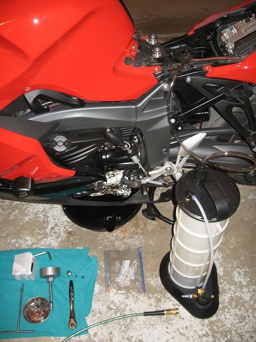

            Oil change today.

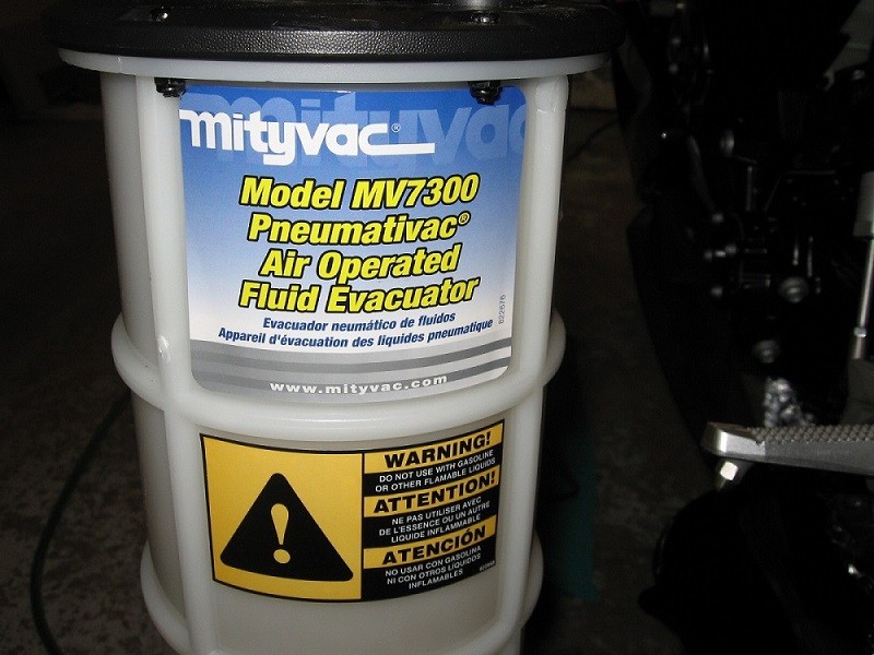

            I liked using the MityVac when we had the K1300S. Like Tim mentioned, I worried about the drain tube breaking after repeated oil changes.
            I had the one that connected to a air compressor.
Name:	Mityvac label.jpg
              OCD tool placement approved by Susan except for the allen wrench in my 2nd picture
              Looks like a surgeon about to operate.
