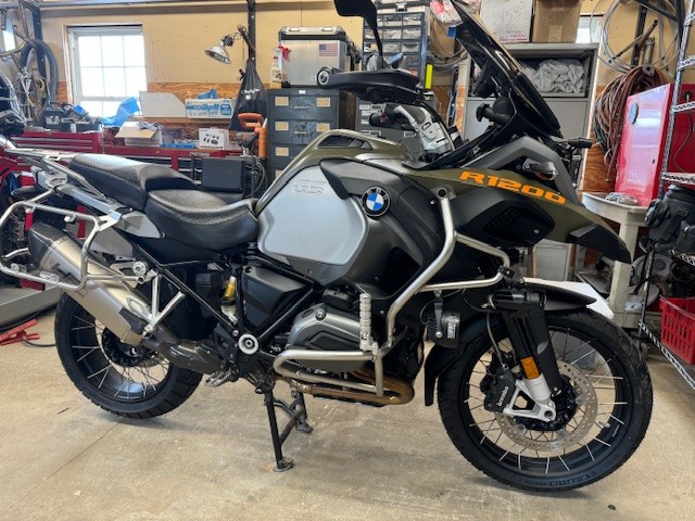

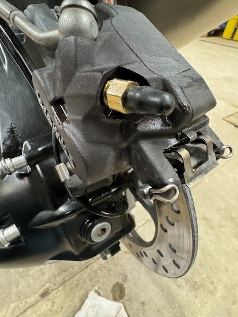

The Speed Bleeders came today and I installed them....
Both of the wheels is still off of the bike because I'm waiting for
some black wheel weights from NoMar. It made it quite easy to
install the new bleeders that way. Hardly any fluid came out in
the process. A little squirt of brake cleaner took care of it. Don't
replace them with the reservoir covers off, more fluid may leak
out (so they say).
There are three different bleeders for the GSA. In one of the YT
videos I watched he said that the front ones were the same. Be
sure to check Speed Bleeders chart for your specific model and

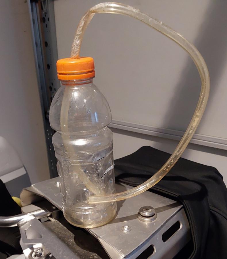

year. I got the bleeder bag and extra thread sealant for future
use. I would only buy them from Speed Bleeders site because I
read that there are some cheap knock offs on ebay that leaked.
There are stainless steel ones but I didn't see them for my bike.

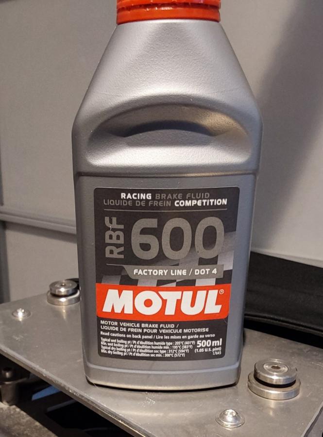

I didn't have time to flush the fluid this evening and undecided if
I will try to use the GS911 and do a full flush of the ABS unit.
The Speed Bleeders have a thicker nut to get your wrench on.
The mud guard is missing also, sort of hit the tool box. Guess
I should've looked up the directions for the used box I bought
which states to remove it or lose it.
